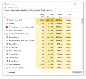

    • Optimized Fast mode – Optimizes codecs and filters based on file extension with focus on fast compression and decompression speed. Up to 400-500MBs speeds in real life scenarios with normal computers (8 threads with SSD).
    • Ashampoo_Snap_2016.12.20_14h25m15s_039_
