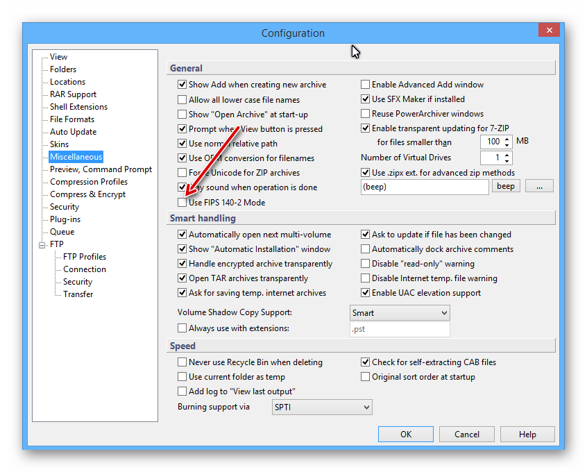

How to turn on FIPS 140-2 mode in PowerArchiver?
Ashampoo_Snap_2014.08.20_12h37m06s_001_Configuration
1. To turn on FIPS 140-2 mode, you have to go to Options> Configuration> Misc and check FIPS 140-2 option.
2. Make sure you send and receive ZIP files encrypted with AES encryption.
By using ZIP AES encryption in PowerArchiver, with FIPS 140-2 mode on, you are satisfying all Government requirements on using cryptographic-based security systems to protect sensitive information during both storage and transport.
